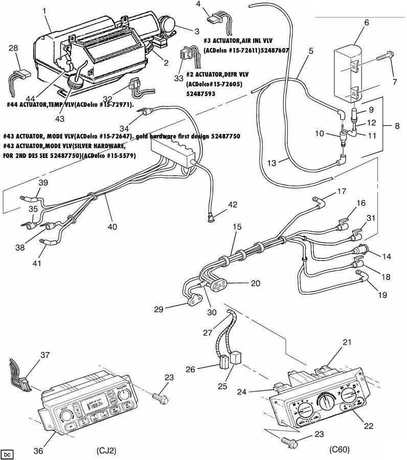

Corvettehvac97 02 Zpsbbd08ddf
first... lets go thru the various settings..
set the system to defrost. change the temp control from cold to hot.. does it vary in temp..  yes or no..
change the speed.. does it change the  airflow..  yes or no
now.. change the mode from defrost to face to floor... does it change just slightly slower than you can control it..  yes or no..
looking at the image above..
#2 controls the flow to the defroster opening.
#3 controls the inlet air.. either from the cowl for fresh air or recirculated air where it pulls it from a grill down above the passenger side feet..
#43  actuator, mode valve.  this changes from the face to the floor openings..
#44  acutator, temp valve..  this changes the temp door from the hot air off the heater core or from the cold evaporator core..
also... which system do you have.. the CJ2 fully automatic climate control. or the C60 manual climate control with 3 knobs??? it makes a difference in how the fan is controlled..
the CJ2 automatic climate control has a circuit board that varies the power to the blower motor..
the C60 system has a blower resistor as far as i know.. individual resistors in the airflow from the heater fan. but on the cold side of the evaporator box.. .. usually under the hood but could be elsewhere.
there are a bunch of things depending on your answers to the above..
