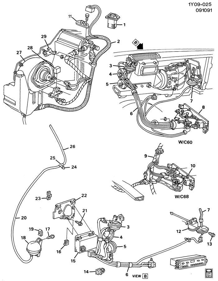

C68 is the automatic climate control.... and is shown on the lower half of this image..  and its still vacuum controlled...
1988Corvetteheateracvacuumhoses
image #17 thru 26 exist on both styles of climate control..  #18 is the vacuum reservoir and is stashed way up in front of the left front tire..
you can see more of the vacuum system in this image...
85C4cruiscontrol
you are going to want to start replacing vacuum hose...

you are going to find dry rotted hose.. you may find some cracked hose.. you may find you need some bigger diameter of hose.. this hose system as you see goes all the way to the brake pedal.. and over to the cruise control servo..  you won't have to replace the hose to the brake pedal.. and usually not anything under the dash board..  you may need a new check valve..
47150 Help Vacuum Check Valve Zps828e445f
is lack of vacuum your issue????? that will prevent the system from switching between the different outlets..
have i done this before.. yep..  that's why i know what to tell you..
its the first place to start.
