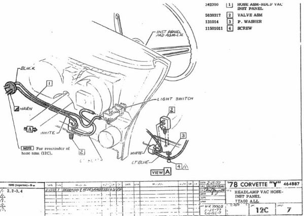

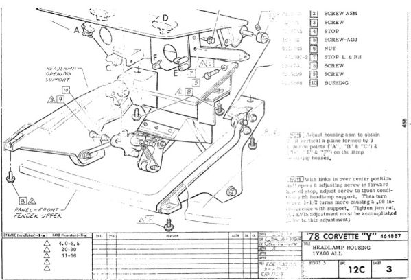

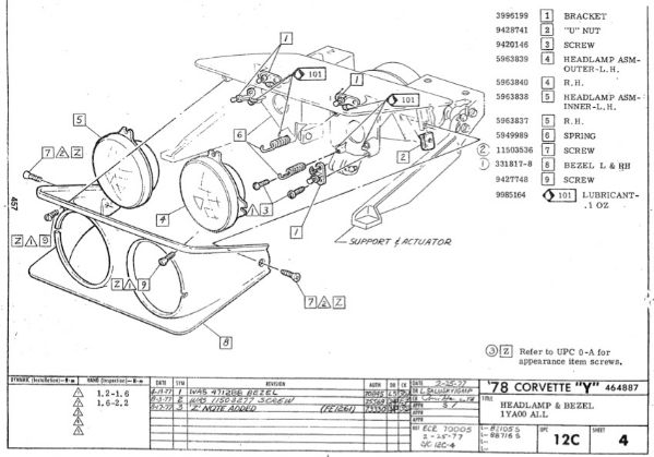

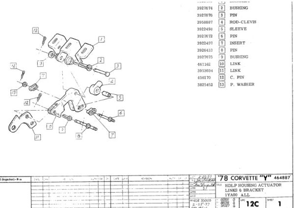

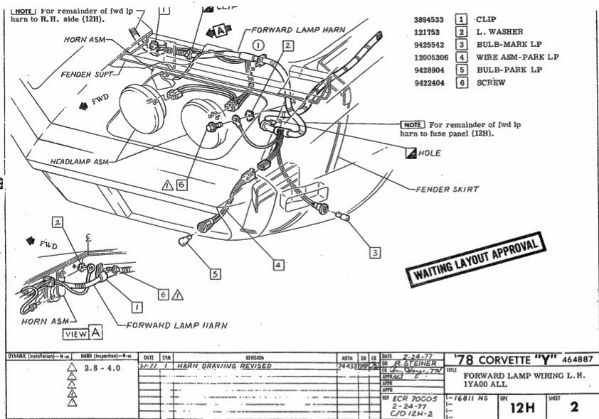

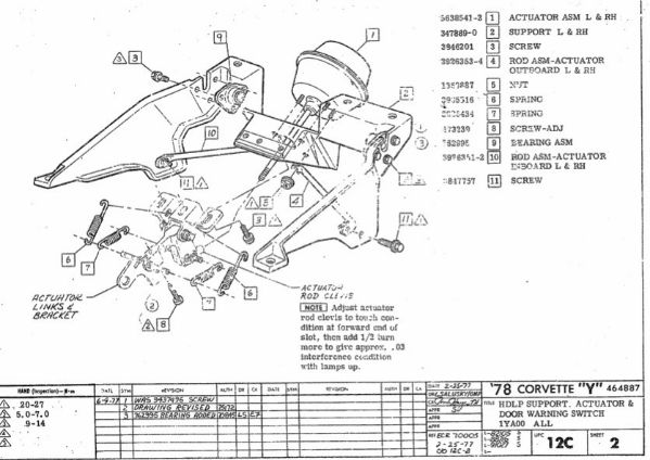

http://www.vetteweb.com/tech/vemp_1104_c3_headlight_repair/
perhaps this will help.
each image has text below it.. so you will need to click thru the images also..
Posts: 31
Posted: 02/25/14 11:52 AM
78 C3corvetteheadlightsupportactuator Zps76db6bff
78 C3headlightactuatorbracket Zps46c46cc7
78 Ccorvettteheadlightsandbezel Zps59f191ee
78 C3corvetteheadlightvacuumconnection Zps94ddba61
78 C3corvetteheadlamphousing Zps4c388e08
78 C3corvetteheadlightvacuumhoserouting Zps203aa69c
78 C3corvetteheadlightswitchvacuumrouting Zpsfc8c7fba
78 C3corvetteheadlightwiringlocation Zpsa1f02244
these might help also.
