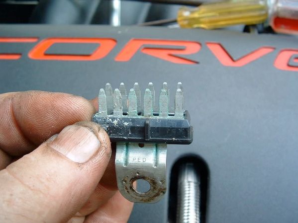

the Right hand door power module is grounded to G202..  and G202 is a splice pack.
right hand side.. behind the kick panel .
this looks good right.. nope.. wrong.. look inside..
Gm Ground Buss Zps90cb8fe0
look at the hidden corrosion..
Gm Groundbusscorrosion Zps3ec9ae3a
hope this helps...
