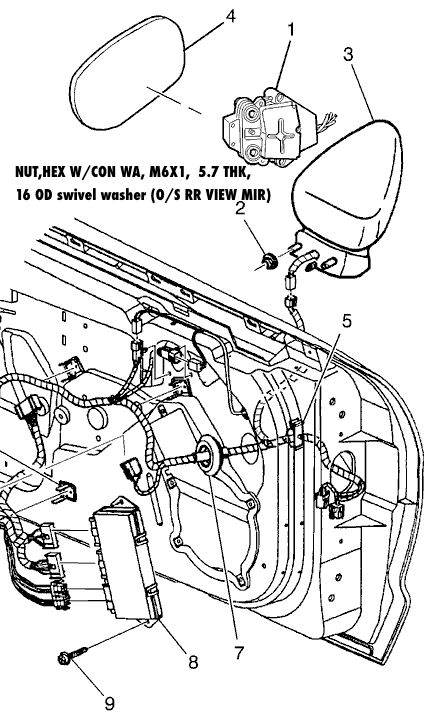

I have a newly purchased 98 in great shape. Got it home and decided to wash off all the bugs from the trip home. The side mirrors normally hinge inward and these after being wet moved back and forth like they were ready to fall off on both sides.After looking closer it looked like the previous owner siliconed the mirrors on to the base. Is there a plastic piece between the base and mirror that needs to be replaced or are they supposed to be glued??

there are almost always 3 nuts with captured flat washers on them holding the mirrors to the door..
07 04 C5 Mirror Zps4712f492
the mirror almost always has a molded rubber face plate that allows the mirrors to mount flush and be stable on the door structure or thru the door skin to prevent vibration.. could the car have been painted and the rubber separated for the paint job. and not reinstalled when the mirrors were reinstalled.. ABSOLUTELY..

will you be able to find replacement mounting parts??? they are not listed individually in the GM parts site i looked at..
