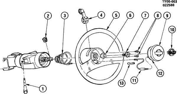

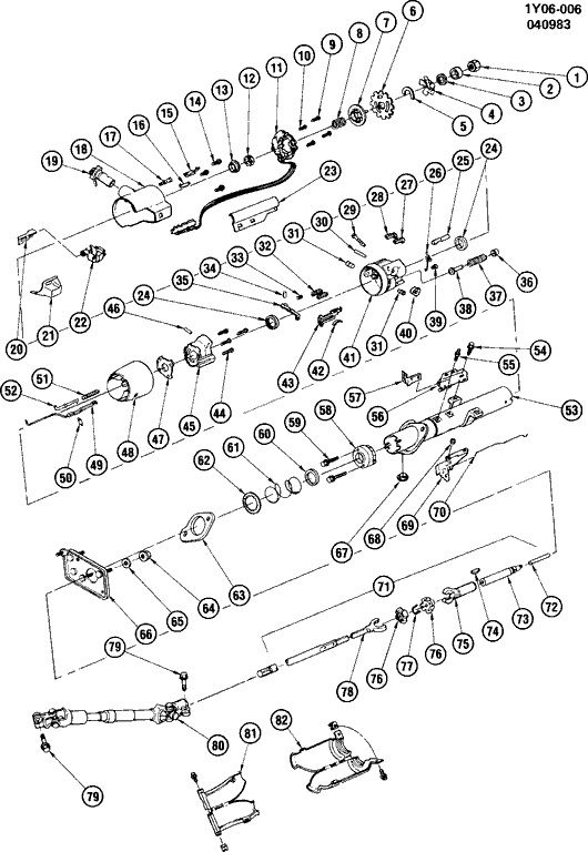

there is ONE issue.. but it sounds like you are familiar ... under the steering wheel push up spring is the insulator device.. sort of a cover for the C clip and it has 5 flat feet sticking out to prevent the steering wheel push up spring from contacting the locking plate..   those are easily broken but available from aftermarket suppliers..
#004 7808385 RETAINER, SNAP RING HORN CNCT CARR
7808385Teloscopicretainer Zps6555bc43
this fits at item 4 below
Steeringcolumteloscopicc4corvette Zps36560f5c
under the horn spring on top of the C clip..
Steering Wheel Horn Corvettec4 Zps055fbb95
i am not saying that this plastic clip will break.. i have just had a bunch of them do exactly that leaving me to glue the parts back together as i usually don't have time to search one out..
