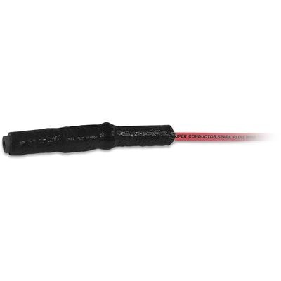

they sell high temp boot sleeves for the spark plug boots...
MSD/6 ft. Pro-Boot Guard spark plug wire sleeve Part Number: 3412

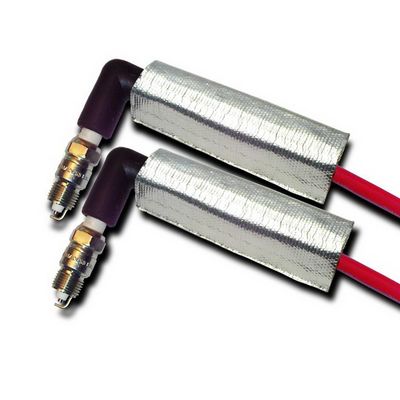

Thermo Tec/2 pcs. 6 x 1 1/2 in. silver spark plug wire heat shield
Part Number: 14200

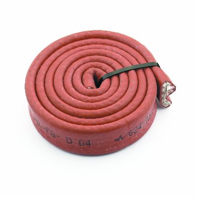

Mallory/5 ft. firesleeve protective sleeving
AZ Price: $112.99
Part Number: 29082

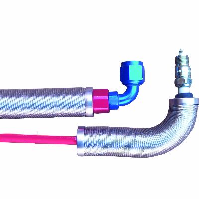

missed some.. there are other sleeves... this one is NEAT..
Thermo Tec/2 pcs. silver Thermo Flex Plug Wire Heat Shield
Part Number: 14300

Thanks, I have looked up these boot sleeves also, shocked at some of the prices. The Thermo Tec ones, Part # 14200 you picture doesn't cover the part of the boot that needs protecting the most. Which is at the 90 degree bend & closest to the header where there is like 1/4 inch clearance, max! I am going to get a set for now. Looking at & having seen the long tube header's on other C4's I see much more space between the plugs & the header itself. In theory I sumise this means more cooler "air" in-between the spark plug, wire/boot & the header itself. Did so on all of my other cars. I am curious however at the Autolite Spark Plug Wire Sets, especially on their Pro Series why the boot is so much bigger- I should say fatter in diameter, and longer in length than any other plug wire sets out there. When I use Autolite vs any other brand, even without the Heat Shield Tape, they have not been burned thru as the Accel sets or any other brand I have used. They also are straight rather than 90 degree, which seems to work best on the middle 2 plugs on either side of the motor. While the 90 degree wires work best on the outside 2 plugs on either side.
