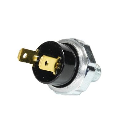

absolutely... most corvettes have over near the master cylinder a single connector for the fuel pump prime circuit....   i don't know exactly where the wire is.. it is shown on diagrams..  but i have not needed it on the cars i have worked on so i never looked for it...
a great diagram of how the fuel pump is wired is this 83 camaro crossfire wiring diagram.. just look at this for the fuel pump wiring..  thats the only reason i am putting this up..
you can see that the oil pressure switch and the fuel pump relay are in parallel...
if you take a rocker switch.. toggle switch.. add some wires to it..   put some 1/4" male quick connects on the end..   you can.. reach in.. unplug the 2 prong oil pressure operated fuel pump switch.. and plug the switch harness directly into both sides...
warning..  this is a LIVE CIRCUIT... IT IS NOT SWITCHED..  if the battery is hooked up.  the ORANGE wire is going to have power on it..
i worry that since you car has been apart a few times.. that if you are having problems like you describe.. that the connectors embedded in the rubber are LOOSE and not properly contacting the oil pressure switch blades...
this is the oil pressure switch that controls the fuel pump...
the terminals are ISOLATED from ground..
the connector for this switch is a wells  1053   you can duplicate this with some 1/4" female insulated quick connects..
