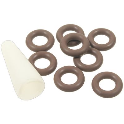

Wayne, I got my Bosch III Injectors today, Saturday, and Monday the Adjustable Fuel Pressure Regulator will arrive from Corvette Clinic. So~ now that I have everything apart and with these new goodies I am ready to install & get this thing running. Question I have is that I saw someplace where you mentioned, suggested using a soapy solution on the Injector O-Rings? I can't seem to find it now. What do you suggest I use to lube the O-Rings before installing? While I have it apart I am painting the runner's & plenum as well as a few other parts that I wanted done when the engine was being built. Just my quirky detail oriented self wanting not just performance but it needs to look good doing so.
Gregorio Lonewolf
Posts: 262
Posted: 03/17/12 06:20 PM
Are you Kidding.. soapy water..
WD40...  white lithium grease...   vasoline..
i have even used a drop of motor oil carefully spread out around the oring to let it slip in...
warning the ford factory upper Orings are a different size as i recall than the GM fuel rail orings..
please.. also.. try to find some reddish colored orings for the fuel side of the injector seals...

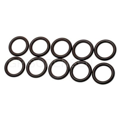

Gp Sorensen/Fuel Injector O-Ring For your 1987 Chevrolet Corvette 5.7L FI 8cyl Part Number: 800-9212
don't accept different parts..
black injector rings can be used for the bottom of the injector..
Gp Sorensen/Fuel RAIL O-Ring
Part Number: 800-9211
this comes with the cold start injector oring...
Posts: 262
Posted: 03/17/12 06:35 PM
these are the proper orings for the threaded fuel line fititngs..

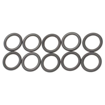

Part Number: 800-9214
this is the large size for the fuel lines and the filter..
Part Number: 800-9215
