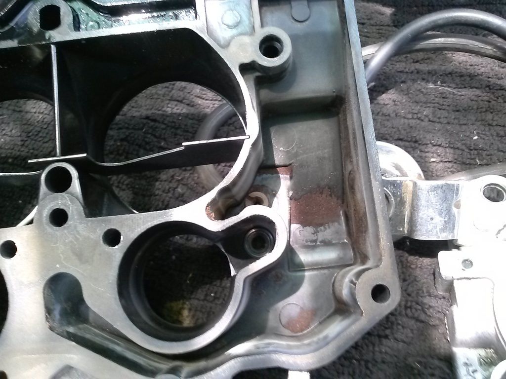

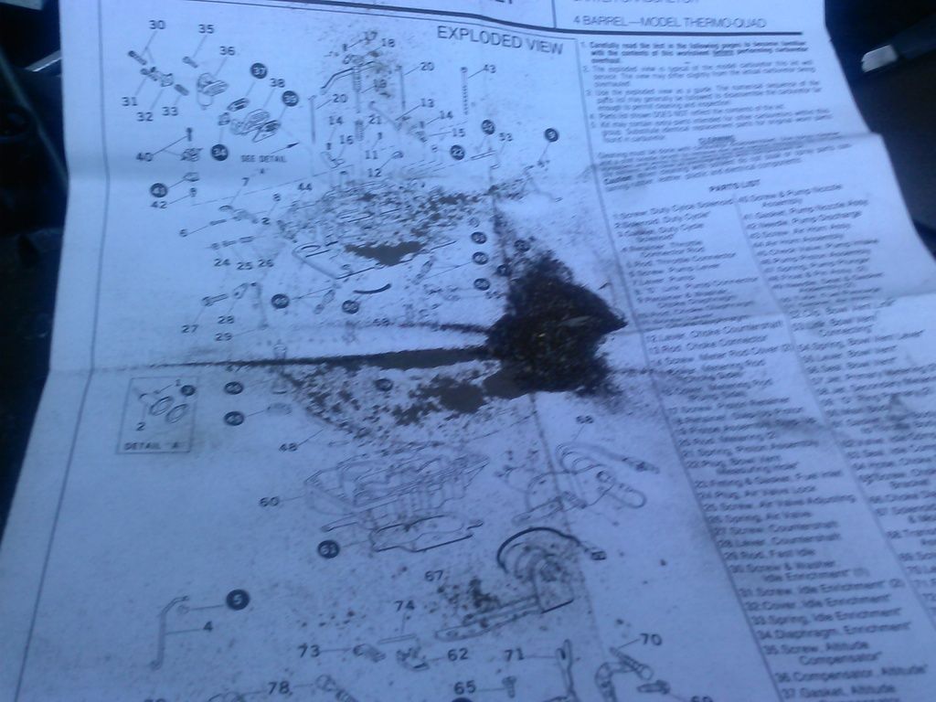

it is totally possible that you have debris in the float bowl that has clogged the tiny passages..   look at the sediment i shook out of an thermoquad.. CAM01676 Zpszkhscgl5
i had actually rebuild that carb only a few days before.. handed them a quality fuel filter to install in line..  well.. they installed their clear fuel filter.. and that let all that sediment thru and clogged the carb again..
CAM01710 Zpswzjgvivb
CAM01711 Zpspxevyuhh
