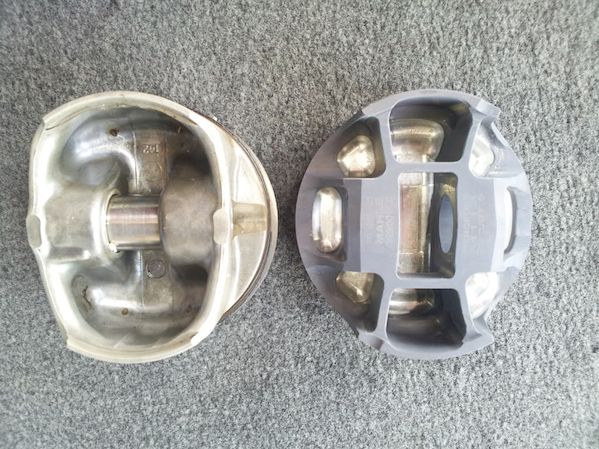

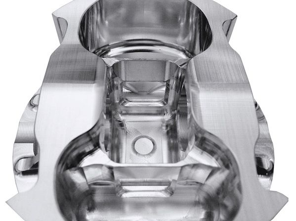

better strut designs for the piston bottoms..
