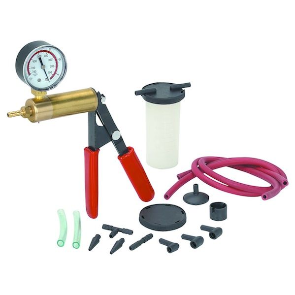

or a brake bleeder  hand pump..
Brakebleedervacuumpump Zps3cb4f76e

oh.. what to do with the pressure gauge or vacuum pump...
disconnect the fuel hose into the pump.. plug or pinch the hose closed with some needle nose vice grip pliers.  or just a bolt in the end..
attach the vacuum pump or gauge to the inlet..
crank the engine.. does it make over 20 inches of vacuum??? it should..  it should also hold it..
you can use your finger over the fuel pump inlet also.. but a gauge is better..
if the pump cannot create 20 inches of vacuum.. it might be suspect..
