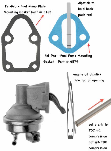

almost every parts store will have the 2 fuel pump mounting gaskets for a small block chevy.
Chevyfuelpumpinstall Zps3a928fe9
as for how thick.. these are usually under a buck each precut..  0.015 for the larger and 0.035 for the blue gasket would be a guess
say.. if you set the crank so the timing mark is aligned and the distributor rotor is pointing at the #1 spark plug wire position. that positions the fuel pump eccentric at the best spot for fuel pump installation..   and a huge hint..   pull the engine oil dipstick.. disconnect the battery if the alternator is on that side.   stick the dipstick thru the top of the opening and inside the bottom of the opening.. you can wiggle it in front of the push rod.. so when you insert the fuel pump lever and push the dipstick back. you can drop the pump into place easily.. instead of needing to fight it..
