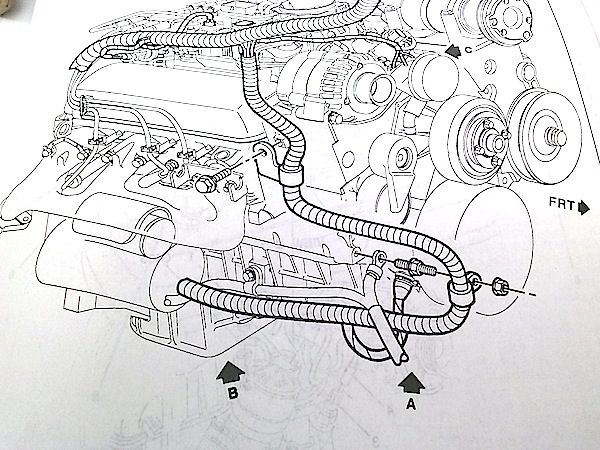

negative to the bottom of the engine block..
Chevyrightfrontlowerblockground1998 Zpsef9309b7

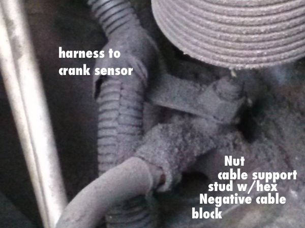

on trucks there are also wires from this front passenger side engine ground location to the frame rail.. yep.. that's half the circuit for the fuel pump and tail lights..  i know i took that off with either a 14 or 15mm wrench.. i used a double offset box wrench to get the nut off to free the crank sensor support then removed the stud so i could clean both sides of the cable ring terminals..
Frontlowerblockgroundconnectionchevy Zpsf909e0c7

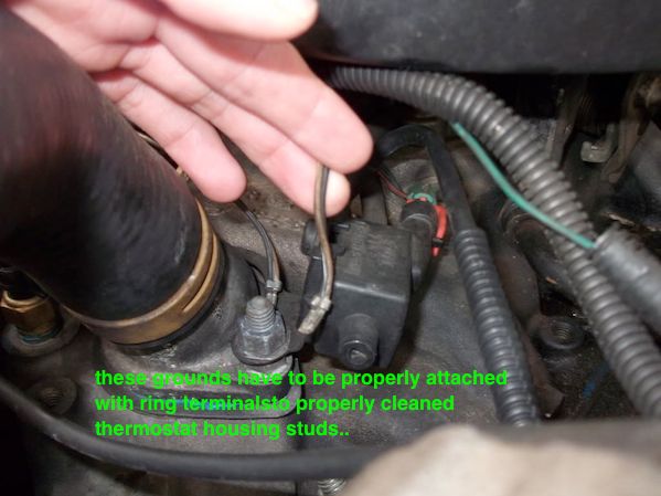

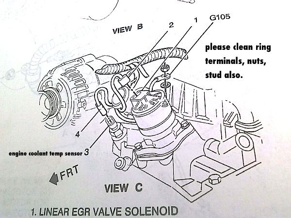

negative to the inner fender..
Vortec G105 Ground Zpsef7519b0
Tbi Ground Zps2317f7aa

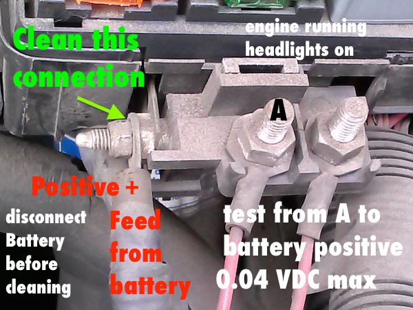

now that it starts.. perform a voltage drop test..
Voltagedroptesting
add 2 tests to the 4 parts..
positive battery post to the underhood fuse box.. 0.04 volts max
positive battery post to the alternator output stud.. less than 0.3 volts ..  thats 3/10ths of a volt verses 4/100ths of a volt as it carries a lot more amperage..
i like to see less that the 3/10ths.. so make sure that your connection at the alternator is clean and tight..
