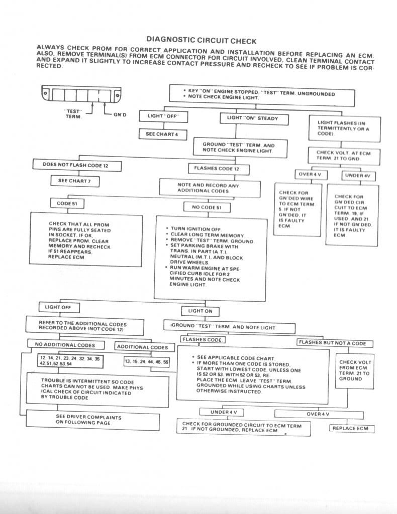

is it a feed back carb.. with 2 wires plugged in above the right front carb mounting bolt???  3 wires into the front of the carb on the drivers side..
and a working check engine light..
that would be a CCC computer command control system..  and it will get you great fuel economy if everything is right..
if you have to pass smog.. and or require the over 20 MPG that should get you if its working right.. then reply with some pictures..  i am very familiar with the system. .
http://www.gmhightechperformance.com/sch/02/grand-national/articles/
please.. run this test...
5B016492 Fb58 4E13 B591 224E9461327b Zps1b1571d3
post any codes you get..
