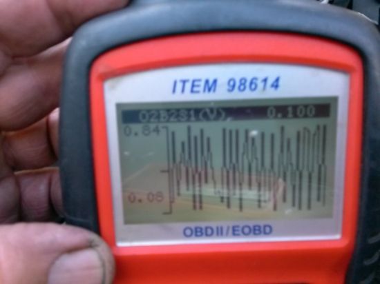

then set up the scan tool to view live data stream and look at the short term and long term fuel trims...  some scan tools will graph the data streams and display them.. do your normal drive with the scan tool up in the front window if it will fit so you can see how deep into the percentages you drive the fuel trim away from Zero during your daily drive..
O2B2S1 Zps69fd0fbd
this is an image of the oxygen sensor readings at 2500 RPM.. try this while you drive also.. on the O2B1S1 or O2B2S1      oxygen sensor bank one or two.. sensor 1.. which is at the exhaust manifolds.. not after the cat..  make sure that you are not driving the throttle so deep that you are flat lining the sensor readings..
