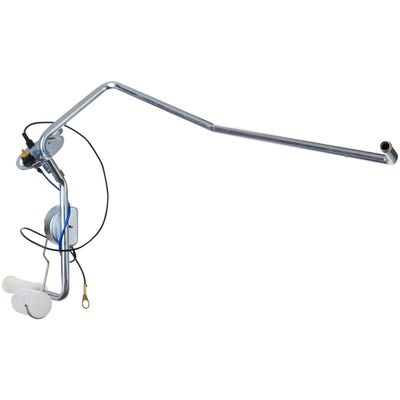

Posted: 04/07/13 07:42 AM
this one has a 3/8 tube..

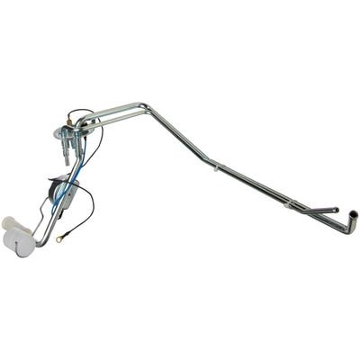

this is the return line version for 69 camaros..
i have seen larger bore versions as i recall.. but you could also modify them by adding an additional tube thru the plate..
