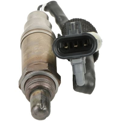

Jet computer chip installed...cooler thermostat installed...New coolant temp sensors installed...all grounds connected... On my headers there are threads for o2 sensor but blocked off...will need drilled and bottom of cab heat shield needs a little clearance...so my  o2 sensor isn't hooked up at the moment....I believe o2 sensor, tbi , computer is problem
Posts: 218
Posted: 03/17/13 09:30 PM
yep...
no oxygen sensor... going to run horrible.. has to learn...
depending on the sensor location.. you might also want to install a 3 wire oxygen sensor from a Bosch/Oxygen Sensor
For your 1995 Chevrolet Truck Tahoe 4WD 5.7L TBI 8cyl
Part Number: 15700
Application: Up-stream sensor (located before catalytic converter)
Notes: 3 wire lead
Oxygen Sensor Connector Type: OE Connector
Oxygen Sensor Type: Narrow-Band Heated
just under 50 bucks.
power from the ignition power circuit...
ground to the back of the head..
sensor wire to the existing purple wire..
you will have to dig around for the oxygen sensor pigtail connector... as close as i can figure you will need this from  delco
CONNECTOR-W/LEADS, 3-WAY F. *BLACK
Part Number:  PT420 might be a autozone/wells 489 pigtail  looks about right but not cheep.
Product Notes:  Inline-To Oxygen Sensor Conn 3-Way female black
i will have to dig deep is you decide to go to the heated oxygen sensor so you keep it at operating temp during lower speed operation...
