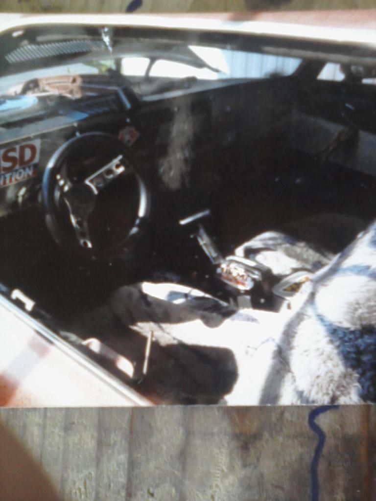

aw man, you guys are hating on the leopard stripes. Frown  Grin
051802 120100
Grin
  i wish i still had that old 78 camaro.   its hard to find a 2nd gen in nice shape for a decent price anymore.
