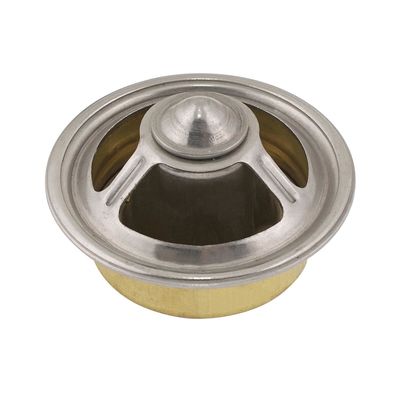

you might want to if you have a belt drive water pump and fan... install a 192/195F thermostat.. try to get one of the heavy duty versions that look like this...  as they have less problems with the mechanical pressure built up behind them.
