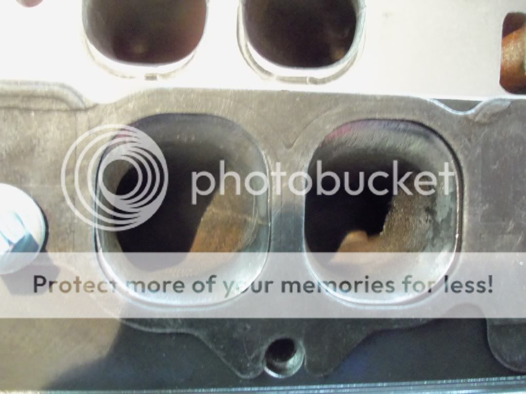

OK, I recently built a 468 BB and I believe that ALL your power is generated in the combustion chamber of your cylinder heads.
So I will post pics of the porting.,. step by step.
Castings 049, 781 and 782 are good oval port heads and fairly easy to find.
I have a good assortment of porting tools and each one has a different carbide burr for specific applications.
The Tools I use
Thetoolsiuse
Finishing Tool
Finishingtool
Oval top Peanut Bottom
5318
Getting Close
Gettingclose 1
Small Oval Ports
Smallovalports
Hogged Out Intake Port
Intport 1
Big Exhaust Port
Export 1
049 Intake And Exhaust Ports
049Intexports 1
Port Matched Headers
Portmatchheaders 1
Ported & Gasket Matched Eddy Top, Stock On Bottom
Gasketmatchportedovalsandstockedelbrockmanifold
Tricked Out 049 Ovals
Trickedoutovals
These ported heads flow about as much as stock rec port heads.,. all it takes is time, about 6 hours per head.

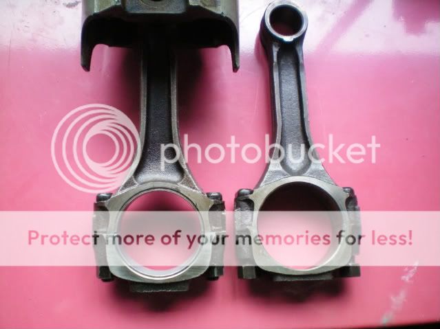

You might want to find a set of beefy truck rods.,. same 6.135" length as stock rods.
Truck On Right Stock On Left
Truckbbrodonright

Chuckles,,,,, yep after 5 or 6 hours per head they'll flow enuff unrestricted air to feed a 468
