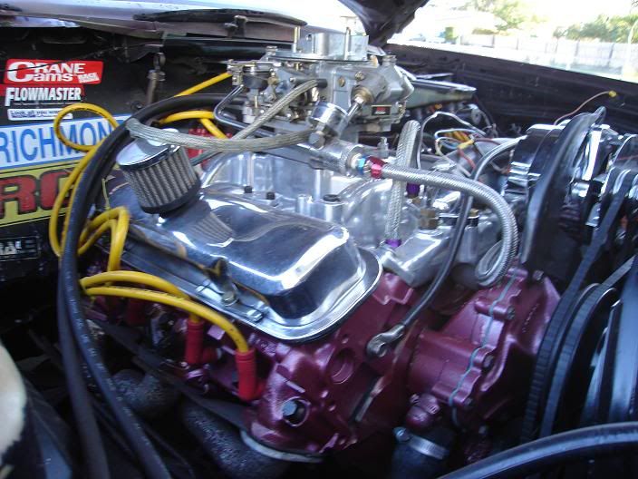

My friend has a 69 chevelle with a 454 and it idles fine but when we rev the engine it backfires through the carb. we replaced the timing chain, the carb is a brand new edelbrock 750 cfm and we adjusted the timing 6 way from sunday with no success. my friend leaves for bootcamp this sunday and we would love to get the car running right so he can drive it before he leaves. please help.
