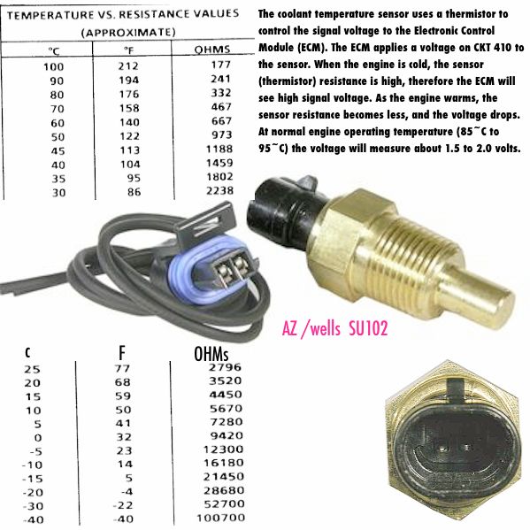

you might also want to change the engine coolant temp sensor and pigtail..  they have been known to drift out of calibration over their years of service. pickup a duralast or wells SU102.. the kit is under 20 bucks.
SU102 Ectsensorgm Zps9f2d9178
