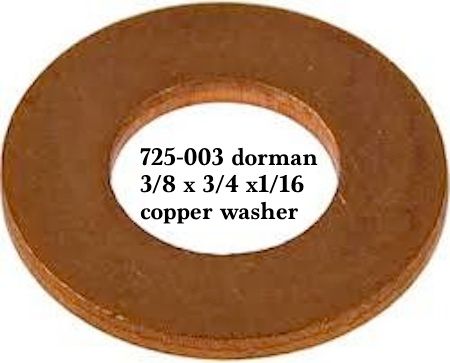

pickup 8 of these if you can get them individually
Dorman - Autograde Copper Washer-1/16 Inch x 3/8 Inch x 3/4 Inch
Part No. 725-003
3 8 Copperwasher Zpsb5b48e37
these will reinforce the studs grip on the battery cable ring terminals when you install them above and below the ring terminals to reduce the vibration from burnouts from fatiguing the ring terminals or loosening the nuts..
will you need to trim them slightly??? don't know.. i actually have some of these in my junk drawer and i use them on the starter solenoid connections..  and yes.. i have to open the inside to use them on 10MM metric studs.. not an easy thing .
