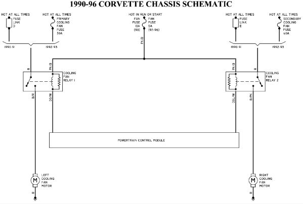

Yeah, this is weird. Both cooling fans start almost as soon as I start the engine. As in I start the engine, then 5 or 10 seconds later, both fans come on.
So, I got out my DVM and a diagram of the engine cooling fan circuit found on CorvetteActionCenter.com. What I found was that the relays were functioning correctly. Which means that either the A/C pressure switch, or the engine coolant temperature switch was closed. Normally, they're both open - when their conditions are met, they close and connect to ground.
Then I tried disconnecting the switches from their sensors by removing the connector caps. Removing either one produced no change, so I removed them both at the same time. No change there, either.
OK, I'm scratching my head, now. I double-checked everything to be sure I had the right sensors. The temperature coolant switch is on the front of the engine, below the throttle body. The A/C pressure switch is on the right side of the engine compartment, by the filler nozzle.
I tried measuring the resistances. Both had a good connection to ground. The other pin on each connector had a good healthy resistance. That's just what I would have expected.
Then I moved to the relay. And this is what I have trouble understanding. The relay operates whenever either of the two sensors connects to ground. Even with both sensors unplugged (meaning they can't produce a grounded signal), the line carrying their signal is grounded, which causes the fan to start.
Looking at the diagram I have I don't understand how this can be happening. The sensor caps show that their signals are not grounded, yet the input to the relay, which is just connected just by wire to these signals, is grounded.
It is a '93, so it's possible that somewhere in the wiring harness, a short has developed. But then, how can the sensor leads show a good resistance to ground? They're supposed to be connected. Unless I'm just not on the right sensors.
Anybody got any ideas?

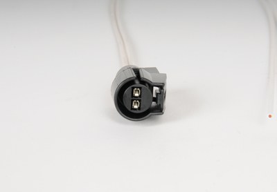

replace the engine coolant temp sensor with an AZ or Wells SU102.. that is a kit that comes with the engine coolant temp SENSOR and a replacement pigtail.. they are under 20 bucks.. there are other brands with both parts.. either sensor or pigtail has failed.. Su102
this has been a nightmare for other L98 and LT1 owners.. as its not always far enough to set a trouble code..
the coolant temp sensor for the PCM is on the water pump a black and a yellow wire.

so it looks like the radiator fan relays are only controlled by the PCM ..

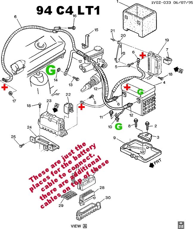

08763492 D472 46Ca 992A 78E9ea806760 Zps7b72cbcd
how many locations can you spot on this drawing below  that match the above...
94 C4 LT1 Enginediagram Zpseed96168
3,  bell housing bolts -
10, side of block above oil filter -
16, starter solenoid top post +
17, on the back of the alternator +
19, ground strap from engine to frame -
20, small ground wire from neg bat terminal -
22, same as 3 above bell housing to engine bolt.
there is another ground to the ignition coil bracket bolt on the front of the drivers side cylinder head. G111
Optisparkg111 Zps59dfb510
oh... this G111 location is the main PCM ground connection..  spend the time. pull the coil and module bracket and clean that pair or three wire ground connection..

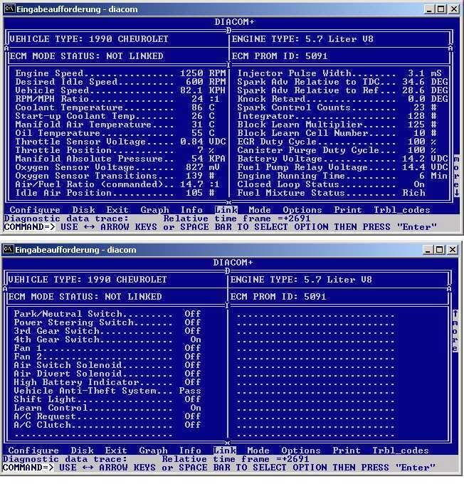

if you look carefully.. you will see that this frame of data was recorded with the car going about 82KPH.. or 50 MPH
take a look at the lower page of data here...
C4livedata Zpsad4aa4a5
see the data lines on the upper page
coolant temp
start up coolant temp.
manifold air temp.
battery voltage..
on the lower page
fan 1
fan 2
A/C request
