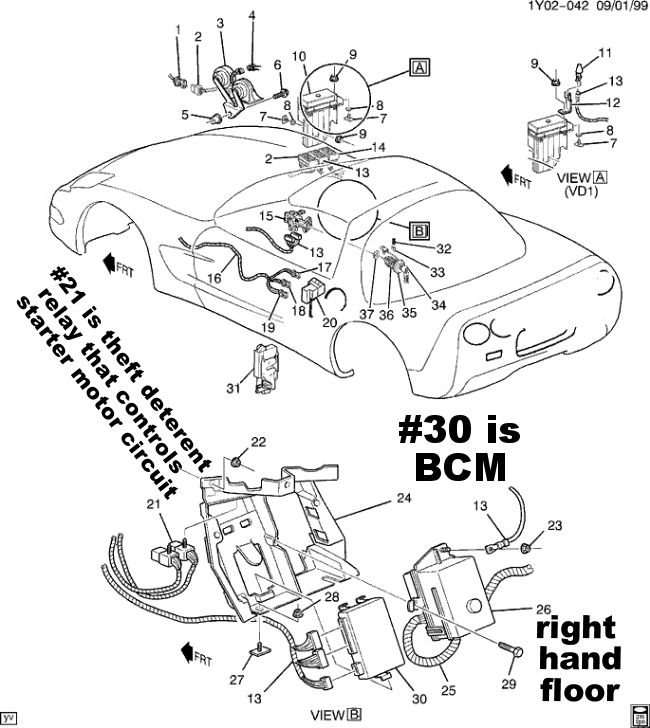

hmm...
021 **193601 RELAY,STRTR THEFT DTRNT(5-WAY MALE, BLACK, CODE 7233)(BLACK)(USED W/CONNECTOR 15306045 W/O BRKTS 5-WAY MALE)(9.277)
Replaced by: **177233
the starter theft deterent relay has been UPGRADED...
2000C5 21Istheftdeterrentrelay Zps14d02e7b
right hand floor... #21 is the theft deterent relay

i would also want to monitor the YELLOW wire into the theft deterent relay socket.. with the relay REMOVED..
verify that its ONLY getting power while the KEY is in the crank position...
do you notice that the yellow wire also goes thru the neutral safety switch or the clutch pedal safety switch.. both of those also have power for other circuits that can short across to the yellow wire and keep your starter engaged..
change your relay first..
there are 4 wires into that relay socket..
a THICK RED from maxi fuse #52.. this should have power all the time..
a THICK purple wire.. this goes to the starter motor..to engage it..
a yellow and black wire.. fairly thin compared to the red or purple wire.. this comes from the BCM.. the BODY control module..
you MAY ONLY TEST THIS YELLOW AND BLACK WIRE with a digital volt meter.. or a Computer safe test light.. touch it with a conventional test light and you will burn out the 800 buck BCM...
and the YELLOW wire from the ignition.. and thru the neutral safety/clutch pedal switch..
