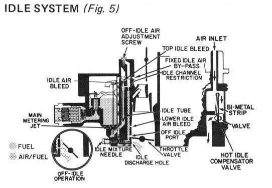

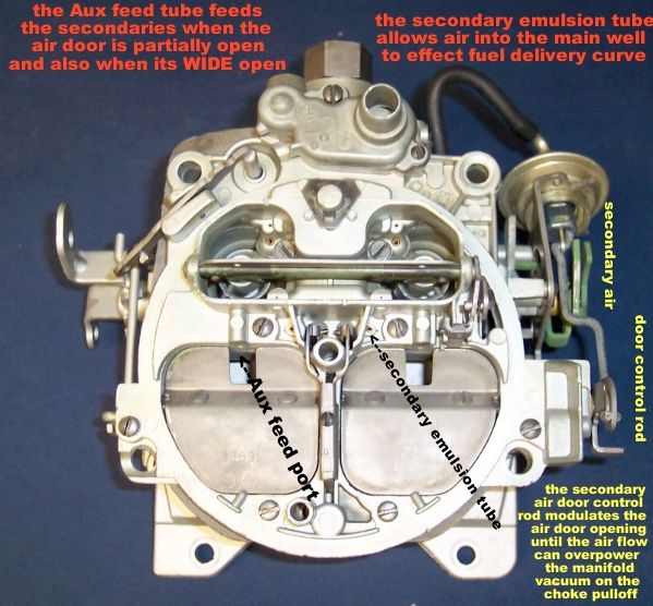

i have some pictures posted.. i will be back with more info...
Posts: 140
Posted: 03/26/14 01:22 PM
your car may or may not have these. i have not had time to check yet...
Quadrajetchokepulloffs Zps1a6a506a
Quadrajet 4M Topcover Pontiacversion Zps8d861a46
Quadrajet Idlecircuit Zpsab2c1514
Quadrajet 4Mdiagram Zpsabfa57f2
