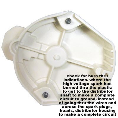

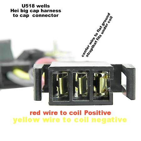

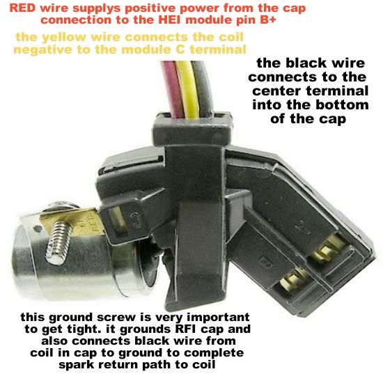

thats strange the 1990 motor still used the big cap distributor..
Untitled4 Zpsec225251
Untitled19 Zpscaa09511
Untitled18 Zps37da024d
Untitled5 Zps63341c9b
Untitled3 Zpsb7fb0c42
Untitled7 Zpsb4b38f49
Hei 4Pinmodule Zps5e505aa8
88 C4 Terminalblockbehindbattery Zpsc49dc171

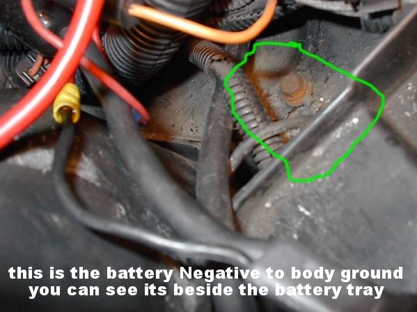

while you are back in there cleaning the power distribution stud..
please see if you can find the thin wire from the negative cable to the firewall beside or behind . you can see this rusty ground location screw...
87 C4 Underbatterygroundconnection
please.. perform this voltage drop test..
Voltagedroptesting
