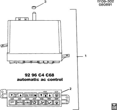

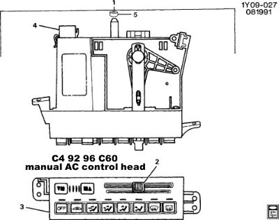

on the RPO label..
C60 is a manual temp control system with slide on the upper right side..
C68 is the fully automatic control system with all buttons including warmer and cooler ..

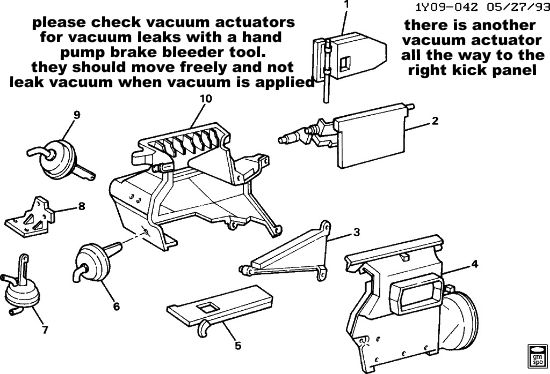

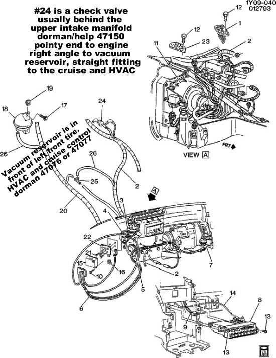

trouble shooting from here requires checking the vacuum hoses..  all the way to the vacuum reservoir ball in front of the left front tire.. checking the vacuum hoses at the cruise control..
checking the vacuum hoses behind the intake where the check valve is for the ac and cruise control system..
this testing needs to include the vacuum valve on the brake pedal.. the hoses to those rarely go bad..
please also closely check the entry point on the firewall where the vacuum hose goes thru..
the rigid nylon vacuum hose is available at most parts stores..
it can have tiny cracks that will leak vacuum at random times..
