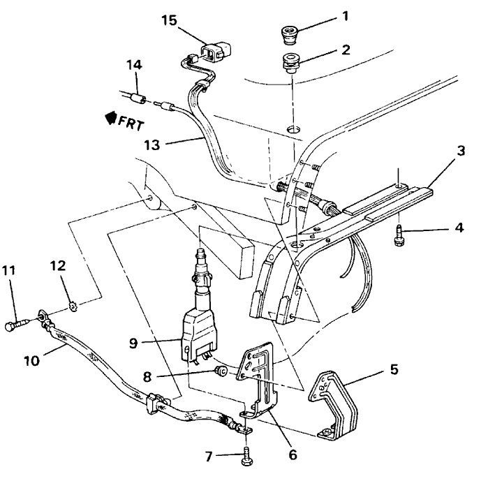

c4 antenna...
http://www.corvettefever.com/howto/corp_0505w_antenna_replace/
C4corvetteantenna Zpsf2b2bdd5
oh.. don't take the bumper off... its just a drawing.. drop the drivers side muffler..
i myself usually remove the hanger.. loosen the clamp and pivot them down to lay on.. so i can work in the fender... this is also a good time to change the brake light bulbs.. the outer housing is unbolted this way.  up from the bottom.. the back up light lense is removed by reaching thru the stop light hole..
be sure to click the link there are several pictures in the article above..
if you have a factory antenna.... and the motor still works.. you might be able to get the antenna kit from GM that comes with the antenna.. but you move the motor over from your original to make the whole thing work.. much cheeper. i don't know if its still available..
