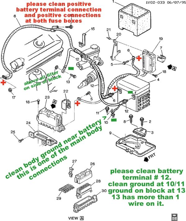

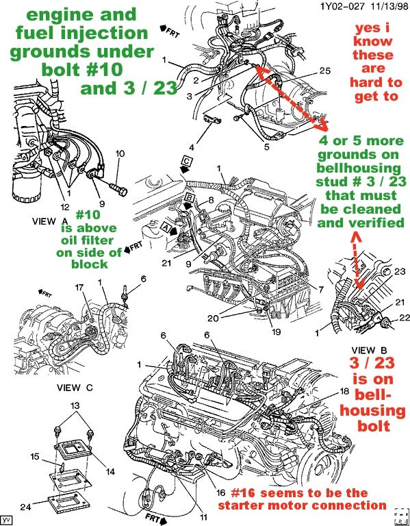

Take some pictures around the firewall and battery tray and follow the wires .
i don't have any good photos of a late C4 to post in the battery cable area..
i did some hacking below...
run the voltage drop test first.. it will usually tell you where the BASIC issues are..
the voltage drop test can be used also on both sides of each connection point..
if you get any voltage reading from the ring terminal or wire to the part its attached to... then you have an issue that needs to be serviced..
Posted: 09/06/13 05:38 PM
hah... drawings
94 C Lt1batterycables Zps57ba2834
94 C4 LT1 Enginediagram Zps6ddaef03
run this test with your digital volt meter
Voltagedroptesting
post results by number
1...
2...
3...
4...

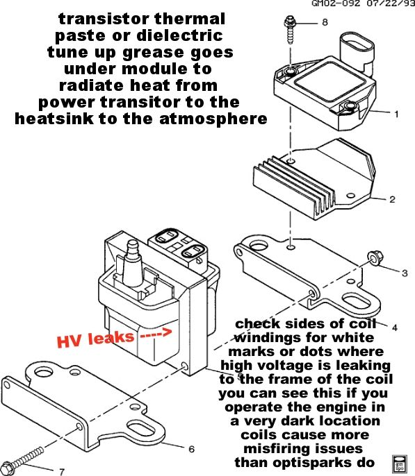

be sure to examine the ignition coil for signs of high voltage leaks..
one tech kept a spray bottle of salt water to test coils with.. along with a bottle of distilled water..
spray some salt water on the coil and the engine would die..  spray the salt water off with distilled water and the engine would start and run again is a sure test of coil high voltage leaks.. salt water is conductive. took that leak straight to ground instead of making it jump to get there..
coils are only a few minutes to replace on these... and are a known failure issue.
94 C4 Coilandmodule Zps398fbcc2
a bunch of years ago... an LT1 powered camaro came into the shop i worked at with a misfire.. i told my boss to change the coil first.. as i could see high voltage leak indications.. nope.. he wanted to change the optispark cap and rotor.. then he did the spark plugs and wires.. and still the car misfired..
i walked over and swapped on the new coil that i always kept on the top of my tool box as i did a lot of them on other GM cars and trucks with TBI fuel injection.. and it ran perfect..
he was a VW air cooled german factory trained tech with over 40 years of line experience. i only had 25 years of experience at that point in my carrier at that point.. a days work.. or 10 minutes  work ..  your choice of which part to change first..
