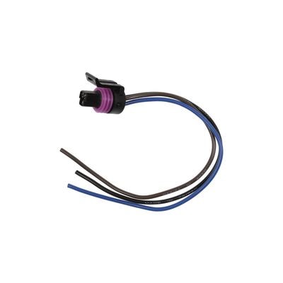

since the other gauges in your cluster seem to be working.. i am going to say.. that it is probably with your wiring.. would you like a part number of a new pigtail for that oil pressure sensor???? post an exact year.. so i am sure of the correct part..

looks like the oil pressure sensor plug is part number 417 at autozone ... or from wells...
i know that part is available in delco and other brands.. but i could not find a part number easy for it...
