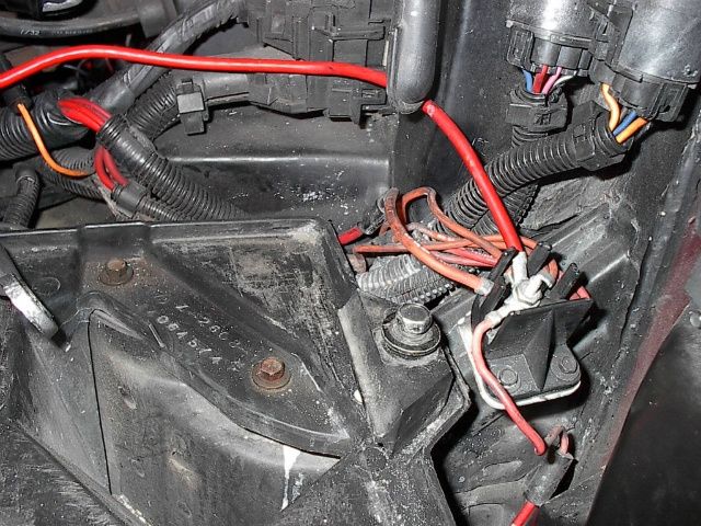

can you find this terminal block over on the drivers side of the firewall.. directly behind the battery tray... as you can see the battery hold down bolt right next to it..
87 C4 Powerdistributionterminalblock
you will want to probe each of the individual wires.. the second segments.. as the soft insulation sections are fusible links.. and protect the cars wiring harness from burning up if there is a short...
there should be power on each one of these wires from this terminal block. when you probe them...
since you will probably have the battery out while wire brushing the various terminals while you have them removed from the stud.. find this ground circled in green...
its got a ground wire on it.. and can cause you issues if its dirty like this one is..
87 C4 Underbatterygroundconnection
these are from an 87.. your probably has similar as 87 to 89 models were very close..
