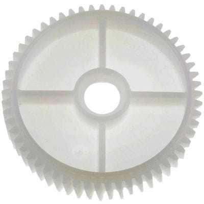

sounds like the gear teeth have failed inside the pop up actuator...
if you depress the pop up doors... with your hands.. will the motors stop...
there are several articles in the 2 corvette web sites here that have a head light door motor gear replacement article... let me take a look around and see if i can find it...

seems the dorman 42400 actuator gear seems to fit your application.
42400
Chevrolet Corvette 2004-97; Pontiac Firebird 2002-93; Saturn SC, Coupe 1996-91, replaces damaged gear inside motor
this is easily available from local parts stores.
since this fits the application... i should let you know..
that out there someplace is a custom machined brass gear..
i have seen it posted around..
