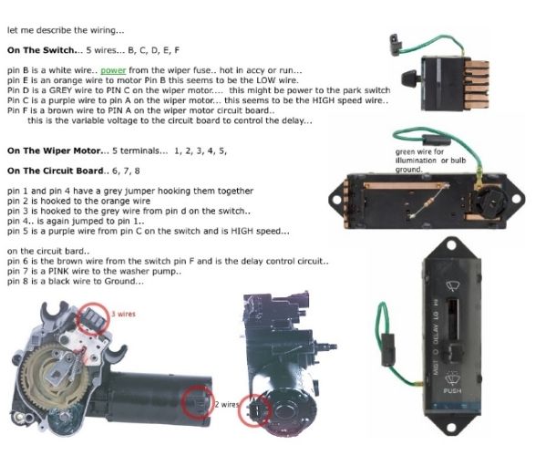

Posts: 181
Posted: 02/07/13 09:30 PM
1984C4wiperswitchandmotor Zpse1d58eeb
84C4wiperwiringdiagram Zps98a829ca
