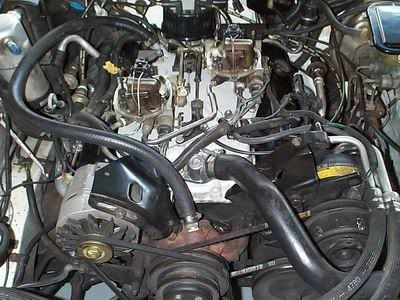

its been a while since i was under the clamshell of a crossfire C4.. but i don't recall seeing an air temp sensor..
lets take a look around...
82Crossfire
82Crossfireintakeview
82Crossfirepicture
84Crossfirewiring
84Crosfirevacuumcal
84Vettecrossfireenginelocations
Posts: 181
Posted: 10/22/12 06:49 PM
