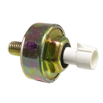

this is the detonation sensor..   these may not be the ones for your car..  yours may be much smaller and there may be two

lets look at the knock sensor info
http://www.autozone.com:80/autozone/repairinfo/repairguide/repairGuideContent.jsp?pageId=0996b43f80cb3f88
the 5.7 motors show the knock sensors under the intake.. the 6.0 and 6.2 motors show them on the sides of the block..
0996B43f80202798
this is why you need a scan tool... but i would change the OIL TEMP SENSOR first.. as that might be the ONLY problem..

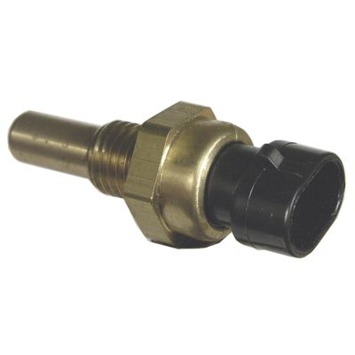

here is the info on the OIL TEMP SENSOR.   but it shown for the 6.0 and 6.2 motors.
http://www.autozone.com:80/autozone/repairinfo/repairguide/repairGuideContent.jsp?pageId=0996b43f80cb3f2a
The engine oil temperature sensor is a thermistor that varies in resistance as the engine oil temperature changes. A low engine oil temperature produces a high resistance at the engine oil temperature sensor. A high engine oil temperature produces a low resistance at the engine oil temperature sensor. The instrument panel cluster (IPC) interfaces with the engine oil temperature sensor via a discreet signal circuit and low reference circuit. The IPC applies 5 volts to the engine oil temperature sensor through an internal input resistor that is connected to the signal circuit of the engine oil temperature sensor. The internal resistor in the IPC measures the voltage and calculates temperature. The engine oil temperature range is between -40 to -165°C (-40 to +329°F).
this is on the bottom of the oil tank... but i don't think that your 97 has that.. but i hope i am wrong..
0996B43f80202f37

this IS where i would start... instead of the knock sensors...
if the computer thinks the OIL temp is way below ZERO.. it will back off on the power as COLD oil is really hard to pump...

oh.. the pigtail connector for the oil temp sensor is duralast #254 at autozone..
if its at the bottom of the oil tank...
replace the pig tail first..   i would bet the wire is broken right at the connector..  does not matter which way the wires are hooked up...  there is 5 volts on one.. and what ever the resistor lets through on the other..
