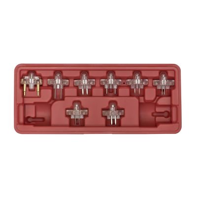

this is a NOID light set from AZ
item 27161... this is a basic tool for crossfire.. TBI and tuned port injected cars...  saves a LOT of grief...
OEM/6 pcs. noid light set
Price: $25.00
Part Number: 27161
disconnect injector.. plug this into the end of the harness and crank engine..  it should flash if you are getting power from the ignition switch.. and the pulsed ground side connection from the ECM...
