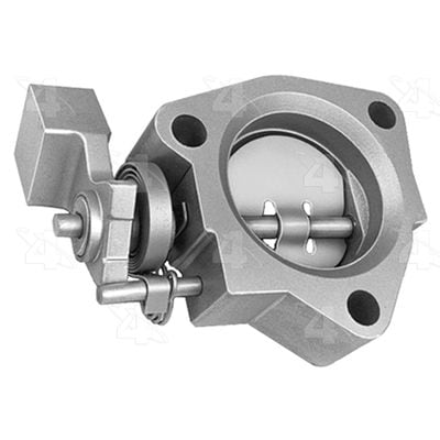

does your car have a heat riser valve in the exhaust pipe where it bolts to the manifold...  why.. when these freeze up.. it blocks the exhaust on one side.. forcing it through the exhaust passage under the intake manifold causing the carb to overheat and boil the fuel....

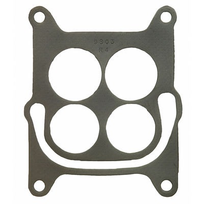

is this the carb mounting gasket you used for your AFB...
there should be a thin stainless steel shim plate that has all the openings this does except the big long smile... that goes first onto the intake .. this goes between the steel shim and the carb...   it protects the base of the carb from direct exhaust gasses...

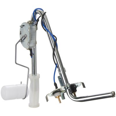

most cars have a strainer on the end of the fuel pick up tube.... inside the tank....
its the white thing on the end of the pick up tube near the float...

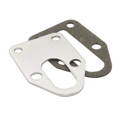

this is all you have to take off to get at the fuel pump pushrod...
warning.. to reinstall this plate...   you do have to at least put the 2, 3/8 bolts in to hold it in place when installing it.. as there is some play.. and you can tighten the lower bolts and have the plate cover the upper holes...

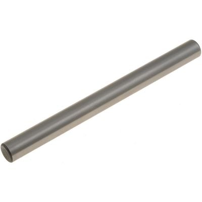

order a new push rod.. most parts stores have them in dorman.. for under 10 bucks.. or airtex for about 30... the fuel pump plate gasket is also available...

Motormite/Fuel Pump Pushrod
For your 1965 Chevrolet Corvette 5.4L 4BL OHV 8cyl Price:$5.99
Fuel Pump Push Rod can easily be lost during carbureted engine service. They can also wear over time requiring their own replacement. Dorman's Push rod is made from solid steel for improved life.
Part Number: 03875
Notes: Dorman - HELP!
Type: Fuel pump push rod
Description: Diameter: 1/2 in., length: 5-3/4 in., fits GM carbureted V6 and V8 engines
or
Airtex Master/Fuel Pump Pushrod
Price:$17.99
Part Number: FP936
Weight: 0.34 lbs
Outside Diameter (in.): 0.498 - 0.499
Overall Length (In): 5.735 - 5.755
