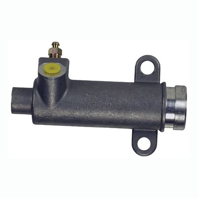

Posted: 03/09/11 06:50 PM
im having  clutch problems im losing fluid and  cant find leak
Posts: 1114
Posted: 03/09/11 08:08 PM
cory.. how about some more info...
if you have a C4... you might have something like this down on the side of the bellhousing...
8506201Y00 002
or with a C5... you get this
9612031Y00 013
