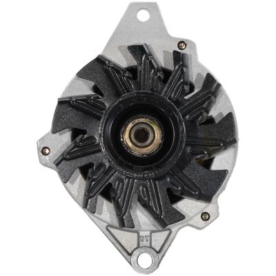

i am also expecting to find that your alternator back looks like this..
the lower right corner is the wiring diagram for the charging system
0900C1528008fda1
you will want to figure out where fusible link B and C is...  and clean those ring terminals with a stainless steel wire brush from the hardware or paint store..   wooden handle versions have stiffer bristles usually...
there could be corrosion problems where the fusible links are bolted...
