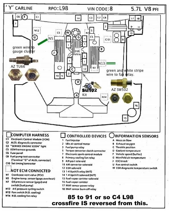

I'd like to see the cooling fan wiring harness diagram if anyone can help. An exploded picture would be great

lets take a look at this that i edited for clarity...
L98 Component Locator
the passenger side gets the temp sender for the cluster. with a flat 1/4" push on connector..
the drivers side gets the fan switch.. but thats anĀ OVERRIDE switch...  so when the engine gets TOO HOT.. both cooling fans come on....
notice the front of the intake with the engine coolant temp sensor in the front of the intake manifold.. is an SU102 kit..   it has 2 wires on it..
the coolant temp sensor  returns voltage from the 5 volts sent to it by the ecm to the ECM.. changes in coolant temp change the resistance and the voltage returned to the computer..
