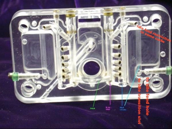

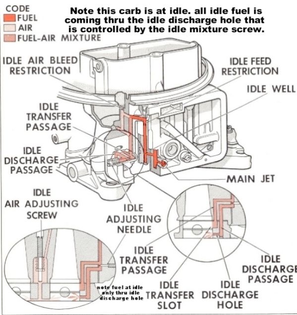

i don't have an exact answer for you...
but surging at the low end of the cruise range is usually a LEAN IFR
fine tuning the IFR is where you can make the carb one you will love..  and where you will get increased MPG.. at cruise engine speeds..
idle circuit is controlled by the idle mixture screw
the idle transition circuit is controlled by the idle feed restriction..
the main circuit is controlled by the main jet..
idle circuit
......--------idle transition circuit---
..........................------primary main circuit-----------
Holley 4150 At Idle Zpsdf8a4c9d
Holley Off Idle Zps85779e58
Metering Block Clear Zpsb13473b5
invest in an oxygen sensor bung installation in your exhaust.. and either a 1 wire oxygen sensor.. or a 3 wire oxygen sensor from a 93/95 gm 5.7 pick up application.. so you can have it hot enough to operate if its installed in the collectors..
then you can get a narrow band air fuel ratio gauge..  mount it on a temporary install so you can tune your motor..
please.. don't go crazy. drill only ONE step at a time..  or pick up an aftermarket primary metering block that has changeable idle feed restrictions..
