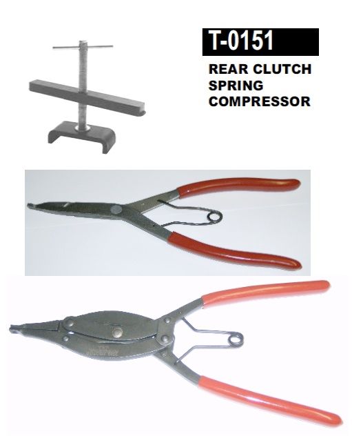

these are the proper tools to install the rear clutch snap ring..
700R4 4L60 4L60esnapringpliers Zpsd530bcc2
i did not have one at one time..  i needed to get that snap ring out.. i actually took some ABS sewer pipe.. cut a Y shaped slot that did not go all the way to the bottom..  used my conventional snap ring compressor to  drive it down .. the y shaped slot allowed me to get in with the one of the snap ring pliers i had..
i think i might still have that pipe kicking around in an old tool box but that one is buried deep..
