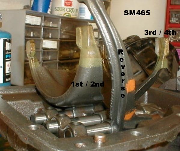

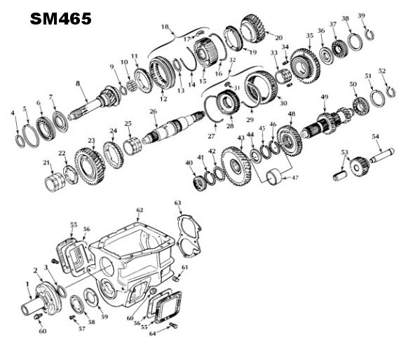

I just bought an sm465 out of a 78 k30 4x4. It's a 10 spline input and 10 spline output. I began pulling it apart and I noticed that reverse gear and shaft wouldn't engage. Then I noticed that the gear actually slid back and forth on the reverse idler shaft. Is it supposed to do that?! Is there a bushing or snap ring missing?? If you have any info. Please help. Thanks.

there is  a reverse clutch fork to slide the reverse gear in and out ... if the gear is in the wrong position when the cover is installed. it may not go into reverse.
Sm465shiftercoverforks Zps2033ec6c
the long shift fork engages in the groove in the reverse slider...
some of the various 4 speed like these.. might need the cover components replaced to tighten up the slop in the shifter levers..

the 465 as i recall has a sliding reverse idler.. to engage or disengage reverse..
#53 and #54 in this diagram...
Sm465diagram Zps500e4bdc
perhaps this will help..

Ok that makes so much more sense now. Thanks so much for the info. I found that diagram a few days ago and have been using it as a reference ad it helps alot. Thanks for the reply.
