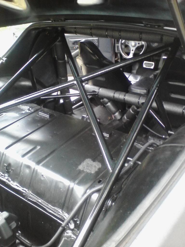

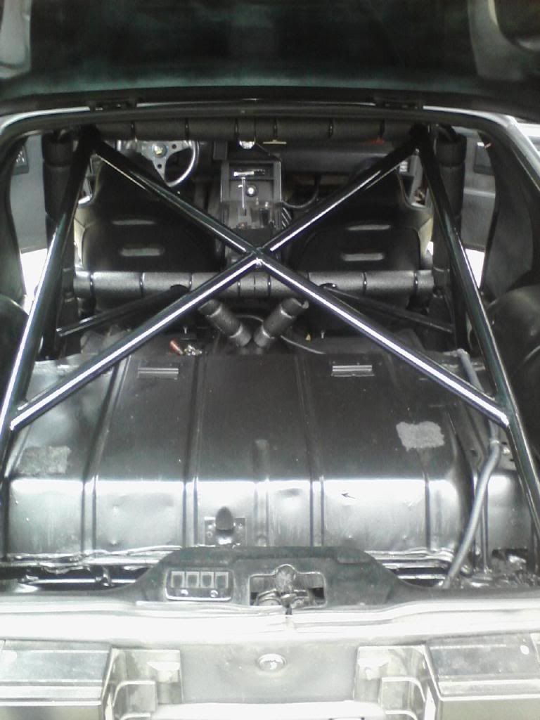

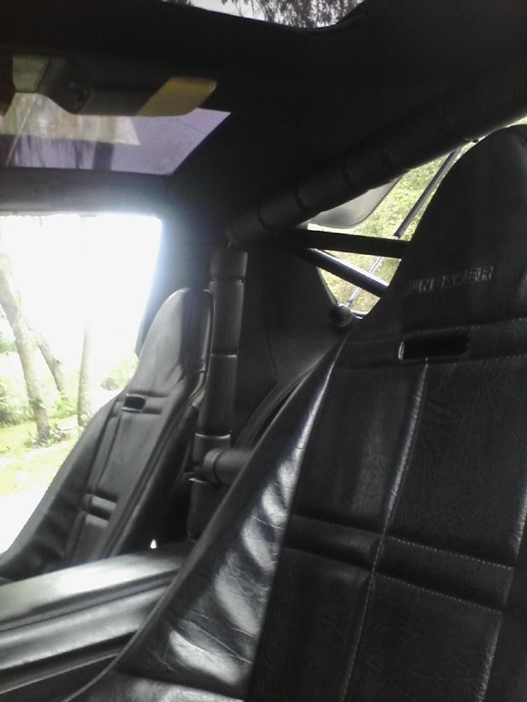

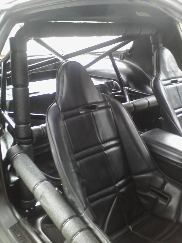

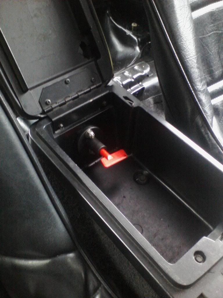

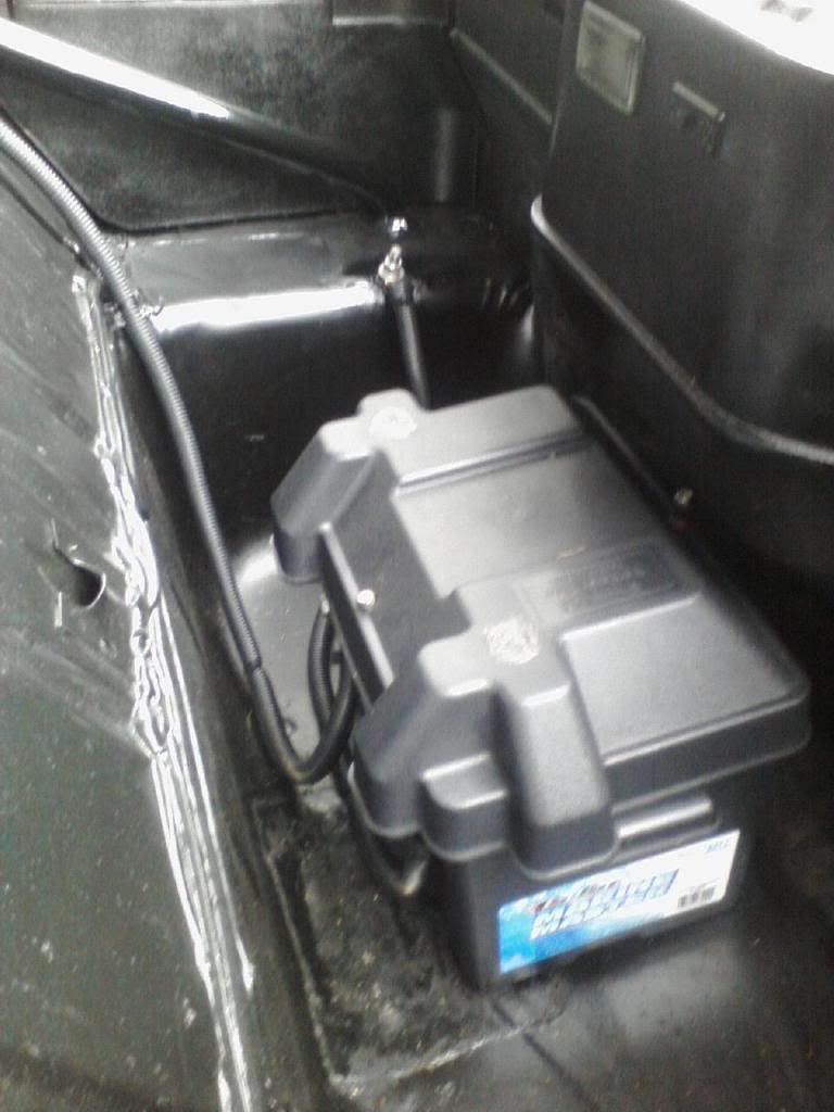

sounds like your headed in the right direction Dale.   theres lots of weight to be lost.   i've seen guys cut the crash bars out of factory doors real carefully, then swiss cheese the door with hole saws, for lighter weight.
  finally got around to some new pics.   what do you guys think?

Looks good joe, I would recommend that kill switch, or a second one, be outside however.

Looks good Joe I like the attention to detail..Not much to look at inside my car.Under the hood yes interior not lol.Nothing speacial there but a tach and a floor shifter.For years I said I would gut my car...I am soon as a trailer is purchased..
Reloacting the battery was a wise choice..I need to do the same mod..That would be a easy 25 pounds off the nose..
Any plans on taking your car to the track? If so please have a camera man handy so we can see you in action..

thanx guys!   it's coming along, (at a snails pace). Grin
autozone lists my battery weight at 32 pounds.  so thats 32 off the front, and 32 added to the rear.  plus the weight of the cables.  i'm hoping it aids in traction.
 if everything goes good, the plan is to hit the track in about 2 months.  i'll be sure to get some videos.  i'm curious to see what it will do.
 i've been thinking about getting a car trailer too.  it makes too much sense.  the last thing i want to happen is be stranded from home an hour away with a break-down.
 Dave, i know the disconnect switch is supposed to be on the outside, cant be keyed, cant be plastic, must push in for "off", etc, but my car is not a dedicated drag racer and i couldnt bring myself to drill a hole through the body or tailights.     i highly doubt the tech at the track is that tough?   if absolutely needed, i guess i can always add another switch?
