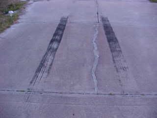

Since we are showing tire tracks here is one from my 68 Camaro. The driveway was cement but even from idle it would just light them up. I had to stop before I ran into the lakeintheback.... Tongue
