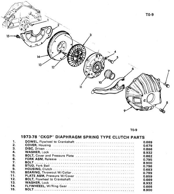

Most likely something wrong with the pressure plate, broken finger, warped, etc. I would replace the plate and clutch disk.

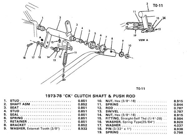

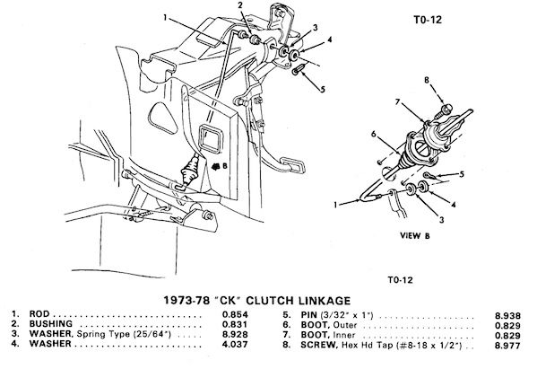

if it grinds attempting to go into reverse... but will slide into reverse with the engine turned off.. the clutch is NOT FULLY releasing..
it could be a bunch of things..
a broken or worn out motor mount allowing the engine to shift out of position..
a broken transmission mount.  these usually don't effect the clutch release.. unless a motor mount is broken also..
out of adjustment or worn clutch linkage..
and yes.. broken or worn clutch disc/cover throw out bearing.. clutch fork components..
lets take a look so when you get back you have a good idea of what you have out of whack..
