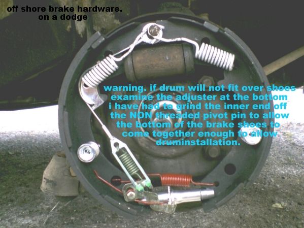

Dartfrontbrakes Zps2a9206b3
note the length of the friction materials.. this is on the right side of a car...  short shoes toward the front..
this is probably very close to what you have on your car...
