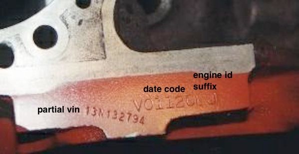

it should  end in the ID suffix..
Sbcstampingnumbers Zps20d2bc7f
post the V0123AB or V0123ABC numbers.. from the right front block surface...
the back of the engine has the casting numbers on the drivers side..
the julian date on the other.. julian dates look like this.. (\)B147(/)
that would be feb 14 1967, 1977, 1987...  can you see how that works..
